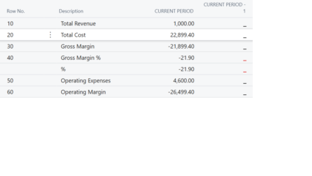

    In Account Schedules / Financial Reporting, the Base for Percentage in a Row Definition does not calculate a percentage by itself.
    It only works when ALL of the following are true:
    1. The percentage is calculated in the column definition
    2. The base row exists AND returns a value
    3. The base row is already calculated
    4. The rows are cumulative‑calculated correctly
    5. The column calculation is Amount Ć· Base
    If any one of these is wrong, BC silently fails (no error, just blank results).
